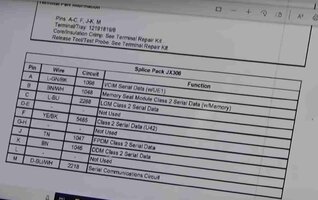

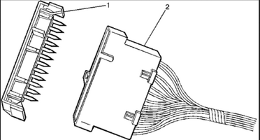

Check Out Will Robinson's Signature Thread - Video on "How to Investigate the Class 2 Network" for Instructions on how to take down ALL of the System Modules that use the Network at the Two Splice Packs:
One under the Driver's Side Dash Kick Panel...
And... One under a Carpet Flap beneath the Rear Passenger Side Seat...
Then, following the scientific idea that you should, "Only Change ONE Variable at a Time"...Follow Will's Step-By-Step Instructions for How to Test and Bring each Individual Module Splice Pack Connection Back On-Line ...gradually... until you find the Problem Module.

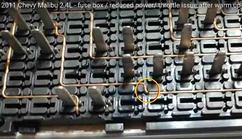

On occasion... the Solid Copper Wire Traces fitted into the Plastic Inner Sandwich inside of the Power Distribution Center can *work harden* from engine vibrations and thermal variance... and Crack apart. With changing under-hood Heating and Cooling conditions... intermittent Starting and Shutdown Events can occur afterward.
There are several Threads here at GMTN that cover how to drill out the Four Connectors and gain access to that area. Then, by using a Bright Flashlight and a Magnifying Glass, such Copper Tracing Breaks can be located and repaired with Lead Solder. THIS is what this phenomena looks like:

Definitely... These Attached Wiring Diagrams often prove helpful in finding the Proper Pin-Outs at the various connectors AND their Harness Color - Coded Wiring, too. Note that some of these Diagrams originated in other Threads as penned and linked by @TJBaker57 's Excellent Contributions.
THIS particular one is for the BCM.... The Source B+ Voltage at 12.6 Volts DC comes through and into the BCM at the C1 Connector Pin-Out A3 via a Solid Orange Wire -- HOT AT ALL TIMES --- reaching back into the Under-Hood Fuse Block on the C2 Connector protected there by the 10 AMP Fuse in Position 31 and ID'd as "TBC1" of the Power Distribution Center (Fuse Box) Layout Diagram linked above.
The BCM Unit Ground has its attachment point located at G302 on the Lower Left "B" Pillar of the SUV and it likewise feeds into the Body Control Module on the C1 Connector as a Solid Black Wire at the Pin-Out B11 and ID'd as "NCA" sharing its Ground with the Data-Bus Ground of S302 as per @Realism 's Epic Grounds gathered by @jmonica and shown in the attached PDF. You can see BOTH of these connections right on THIS Diagram below:
