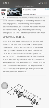

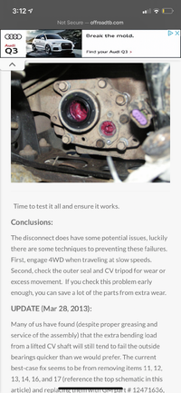

Read this thread on offroadtb about the Awd disconnects and how it has issues cuz of the extra bending load on a lifted CV shaft seems to tend to fail the outside bearings rather quickly. To fix it they are doing the awd sleeve mod, my main question about this is, how quicky do you think the awd disconnect system might fail? Im a tiny bit worried about the current state of mine, mainly cuz most of the miles on the truck are not from me. So i dont know how many times the previous owner switched to 4x4 while moving, i know its bad to switch it while moving. Before i knew that i switched it into auto4 while driving, maybe two or three times. I do test my 4x4 system once a month to make sure its all good, everything feels good so far. Just a little paranoid i guess. Especially after all the BS we been thru lately.

The sleeve is more to prevent the failure of the shift fork and dog gear by eliminating them. I don't think it would help much for the outer bearing failure. @HARDTRAILZ might have some ideas on this.
I know one mod those guys do is add a grease zerk to the disco to grease it on a regular basis.

A: The bearing is still in the same spot and gets the same load with or without the sleeve.
B: AWD sleeve is to not have to worry about the fork engaging or not engaging. Simply to take out a moving variable, not for bearing.
C: It is not bad to switch while moving. It is made to be able to go in and out of 4x4 on the fly while moving. You cant switch to 4-lo unless stopped, but popping it in 4-hi is fine even at interstate speeds. Been there done that.
D: Not sure what you are paranoid about.
If you are unsure of previous maintenance...simply pop the disco in half and regrease it unless something looks work. If it looks worn and you want to eliminate the fork moving, then do the AWD sleeve. If you regrease, the fork is likely fine for a good many miles. The AWD sleeve is not a fix all by any means. I actually destroyed one. Not sure when I redo the front if I will go with the sleeve again or just new grease and one of the forked ones I have.
