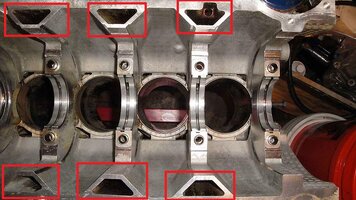

You could do BOTH...But Mind You... Regular Paint Thinner has some ADDITIONAL properties that the Oder-less Flavor does NOT possess. And again, refer to that Dupont Teflon (PTFE.PDF) Document I linked above to make certain on whether or not there are any sort of Chemical incompatibilities prior to using that Solvent. Ordinary Paint Thinner is also VERY High in VOCs and is therefore much more Flammable when used out in the open air.
So I would suggest also Disconnecting the Battery Negative Cable prior to using this type of touchy solvent just to make certain there are NO Ignition Sources around and active once you start pouring the stuff down inside the Oil Filler Neck. Having a ABC Fire Extinguisher close at hand is a very good idea.
One other observation concerns the presence of the Carbon Clogged up 'innards' of your Motor; in particular, those 'Rhomboid Shaped' Oil Drain Down Passages cast into the Engine Block walls for rigid strength enhancement. THAT is where the Engine Oil cascades down from the Engine Head in order to get right back down into the Crankcase reservoir. The Gerotor Oil Pump in the Atlas Motor is capable of moving over 11 Gallons of Motor Oil Per Minute through the Oiling System.
Your posted images indicates that Flushing the Upper Engine Head with a Good Solvent with the Valve Cover OFF in order to completely clean out those quasi-tube drain down pipes would not be a bad idea at some time in the future. The Attached Image shows how 'patent' (Open and Clear) those "Tubes" are supposed to be in order to drain properly. It might seem highly unlikely... but if they are ALL as occluded and blocked off as the one depicted in your photo... enough Motor Oil could get pumped up into the top of the head at Higher RPM to fail to return fast enough down inside the Oil Pan and replenish the Oil Supply. Just sayin'... it MIGHT be a contributing factor.

Thanks I'll look into it. Just got home with a new gauge, and had a look at the pickup screen, and it was about 50-60% plugged again. I started straining the new oil I drained before leaving, and there was enough crud that the oil had a hard time flowing through my makeshift filter.
I also bought a pump sprayer and attempted to spray everything down with the chem dip, but didn't have any real success. I looked at pneumatic sprayers while I was at Harbor Freight as well, but the tips are too large to fit through the drain plug opening.
I don't see any options other than multiple engine flushes at this point.
