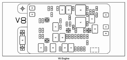

7,841
And since you (Mike) already know of these issues, but others arriving may not, having the Two Fuse Box Layouts for BOTH the I-6 LL8 and V8 Engines in BOTH the Under-Hood AND the Under Rear Seat Fuse Block Layouts might prove helpful in seeing any differences between the two... here they are.
Note that these images were extracted from the 2005 GMC Envoy Owner's Manual available at GMT Nation... and via THIS Link:
https://www.manualslib.com/download/61408/Gmc-2005-Gmc-Envoy.html
The OM does have additional information regarding the behavior of the Electrical System during KOEO that is also worth knowing BEFORE beginning any Parasitic Draw Testing. Knowing which Circuits are "HOT AT ALL TIMES" can also aid in finding STGs (Shorts To Ground) that will be easier to check off if they are highlighted on all of these Fuse Box Layouts dependent upon which Sub-Models are involved.
Checking the Green -N- Gold Flex Cable attaching the BCM Module to the Fuse Block in the Under-Seat location for Damage and the Rear Lift Gate for the Thru The Grommet locations for Breaks in the Wires might also help to eliminate them as locations for any STGs.
RAPINFO.jpgBATTERYRUNDOWN.jpgFUSEBLOCK.jpgL6FUSEBLOCK.jpgV8FUSEBLOCK.jpgGMCENVOYFUSES1.jpgGMCENVOYFUSES2.jpgGMCENVOYFUSES3.jpgGMCENVOYFUSES4.jpgGMCENVOYREARFUSES1.jpgGMCENVOYREARFUSES2.jpgGMCENVOYXLREARFUSES32.jpgGMCENVOYXLREARFUSES4.jpgGMCENVOYXLREARFUSES5.jpg

@mrrsm You are amazing for posting the differences in the fuse boxes! I'm hoping once it's said and done, and I find the culprit this could prove to be useful FAQ for those who may have a similar issue in the future!
