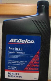

- The front diff, located just behind the driver's wheel got the Valvoline Synthetic oil.
- The Transfer Case (which I accidentally called the Rear Diff) got the Auto Trak Fluid. Once I removed the top Allen Bolt, I checked to make sure the fluid was "somewhat" blue. I then proceeded to remove the lower Allen Bolt to drain, then filled with new Auto Trak Fluid.
Changed both of them today, and had a minor issue getting the auto trak fluid into the transfer case. I should have just bought and used a
oil pump, but I thought I could get away without using one. I kinda made a mess, but the fluid is finally where it needs to be and is level at the bottom of the top fill hole.
