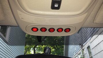

I used the same kind of setup as Regulator for my blue lights, except I have 4 switches up there. Very happy with the way it came out. When I am out of the hospital I will take some pics of it.

I also used silverunicorn's work as a model for my overhead console switch mount. Great work Chris!! There is more than enough room inside the console to play with. There is also lots of room to fish wires out to the A pillars. I have pictures somewhere......
Marc.

KaRo said:
Installed two switches in the roof console:

mcsteven said:
I really like the design of these switches but have yet to locate them. Can you tell us where or post a link to where you got them?
Thanks.
MCS
Probably Berlin... :wink:
I just noticed his location. But Berlin also has access to ebay and Amazon, so here's hoping....
KaRo said:
The switch has a product number:
r13-112lp-02
Google the number and hopefully you can find it. From the technical specifications it is for 220V not for 110V so i think you only could get it in europe, but maybe someone ships to the states.
Here is a link to the seller in united kingdom:
SCI R13-112LP-02 LED GREEN 6A Illuminated Toggle Switch, SPST, On-Off, 250Vac from Conrad Electronic UK
So hopefully this helps
Karsten
Thanks Karsten.
I found them at a few locations, one of which I've used before.
103-R13-112LP-02G-EV Mountain Switch | Mouser
A few other places had them but I've dealt with this vendor before and it's a fair price.
Marc
