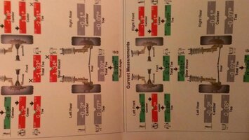

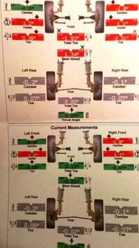

I purchased a set of 4 used TB wheels and tires for when everything else is straightened out, and I found that the driver's side LCA had been pushed back so that it was contacting the frame, causing the grinding. I also took it in for an alignment, and was told that right front outer tie rod was bad, and after getting home I realized it was really loose, and replaced it the next day. After that, I took it back for the alignment, and the manager said that they could not completely realign it, but that it would wear evenly. It still pulls to the left, but the steering wheel is pretty close to center compared to how it was. I have included a copy of the before and after. For what it's worth, they said they "maxed out" the right front LCA adjustment for the camber and caster. I did notice that they made the camber worse, by .1, so is it possible they moved it in the wrong direction?
