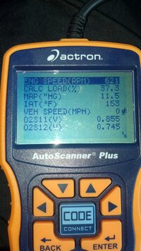

One thing I did notice today, I hooked up my actron scanner that reads live data, I was looking at the MAP HG readings... at idle it was sitting around 9.8HG and when accelerating from a stop it would go up to around 28.6HG :eek: ... from my understanding on vacuum, it should sit around 17-18HG at idle, and go down from there as I accelerate correct??? :confused:
As the throttle opens, more air/fuel mixture is being allowed in which should lower the vacuum closer to ambient pressure right? so if the vacuum is going UP when I accelerate my suspicion seams correct?

my scanner gives me inches of mercury, I do have a haynes manual. I understand what it is showing me... I just don't understand WHY it's showing me. when I accelerate the vacuum should go down, and at idle it should go back up. It is doing the opposite.
I thoroughly explained it in my previous post. does anyone else not understand this? It looks pretty cut n dry
The sensor reading is an absolute pressure value. Referenced to zero pressure as in outer space. Vacuum readings are generally gauge readings - referenced to atmospheric pressure. Your + 9.8 absolute sensor reading is equivalent to -20.2 in Hg gauge if your local atmospheric pressure is 30 in Hg absolute.
