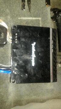

There are thin places under the rear seat, especially if you don't use OnStar and can remove the module that's under the passenger side.
I have my rockford under the rear seat, it is where the onstar module would be, but my TB didnt come with it.
I also have a smaller alpine under the passenger seat, Ive never really had any issues with salt, ect. but it is something to think about for sure.
