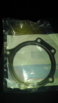

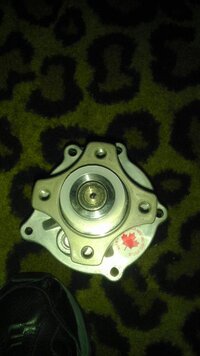

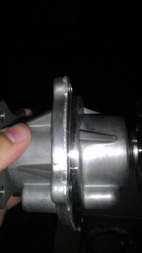

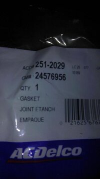

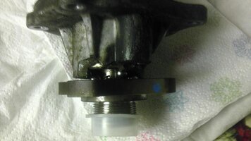

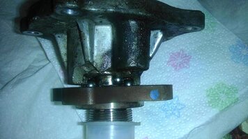

Thanks will keep it in mind.... last night ended up getting a ride home on a tow truck, water pump completely failed, coolant all over the place... Received pump today, and PN 251-731 comes with the good gasket, so now I have a spare...
Here are some pics, maybe they can be of use to one of my fellow GMTnation members...

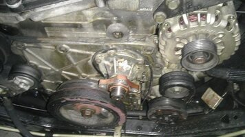

My brother in law used this handy "SPECIATLY" tool to hold the Pulley bolts in place, I think I'd still be going at it right now if it wasn't for his help.. took about 2 hours total, was having trouble with the fan Shroud.. used a dremel to notch the part of the shroud where the Radiator neck becomes a pain at...
