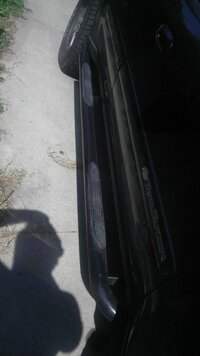

Mine broke a little about 2 months after I bought mine. I determined it was from sliding out of the seat, so now I use my nerf tubes when I get out. I found a pretty good set for ~$150
