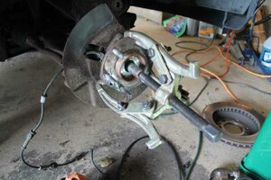

Use a puller like this.
Wow, that's impressive. Do you have a link?
I had the rented puller on my air impact and it wasn't budging. You think hooking differently like the puller you posted would help?
It's just a run of the mill gear puller. I think it's a 6".
That's strange that it won't budge. I used the puller, but didn't feel it was necessary because mine came out so easy. Most people hit em with a BFH. Hit it with PB blaster too.
http://www.toolking.com/performance-w137p-6-inch-3-jaw-gear-puller?CAWELAID=430276038
