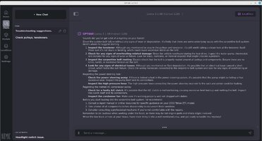

On your behalf, I Copy-Pasted your entire Post #1 into my Off-Line and Private AI Chat-Bot called "GPT4ALL" using Two Different Large Language Models that responded as follows:
My suspicion is that Your A/C Compressor is seizing up enough to cause this catastrophic Serpentine Belt Failure if the A/C was turned on at any time prior to the Belt Failure. Your examination of the snagged Serp-Belt Fragment would bear this out and the fact that the Magnetic Pulley "Spins Freely" only indicates that the Mag Pulley Bearing has not failed... and you would NOT be able to tell that there was a problem within the A/C Compressor... since it is in a static, non-turning condition whenever the Mag Pulley is NOT dynamically engaged with the Engine rotating and driving the compressor via the Serpentine Belt taking power off of the Harmonic Balancer-Crankshaft.
Hope This Helps...
PS... Using a FLIR Infra-Red Camera facing the area of the Radiator would reveal any COLD Blockage points inside indicating the the need to R&R a Blocked Radiator.

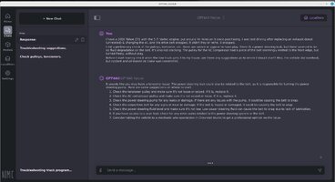

View attachment 116664View attachment 116665
Hope This Helps...
