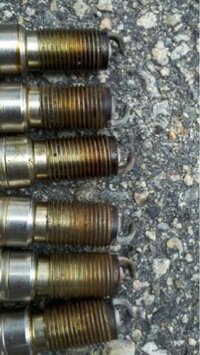

Alt and batt check good doing plugs now
Old plugs
So far so good rpm is steady and running better and the wrong plugs were installed

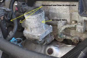

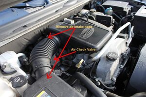

Hope this helps a little. I did create a thread on the OS regarding this. Here are some pics from it....
This is the pump and relay. Located on the frame rail under the drivers side behind the wheel well.
This is the location of the valve
Once I had replace the valve I took the old one apart and found out why it wasn't opening.
View attachment 4657View attachment 4658
