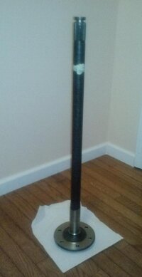

The SS axle I installed awhile back ended up having bent axles, seller sent me replacements and they were bent as well but not as much. So I took a feeler gauge and put a .005 behind the RH and a .010 behind the LH rotor so the wheel would stay true. If the flanges were flopping all around I would have sucked it up and dropped about $400 for a set but the Band-Aid is working.
Unfortunately there are no aftermarket axles yet for the SS rear so I lucked out and found one in Michigan for $120 and is brand spanking new. :wootwoot: Still has the grease slopped all over it.
One down one to go.
