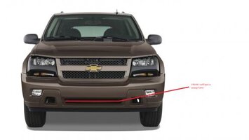

Yes, i personally am going to try and thing of a way. WITHOUT EFANS. I was thinking more under the lines of Thin aluminum? Ran up and around the filter thus creating a air box and ram air intake?? Thoughts? I dont think PVC would be worth doing unless you did 3" or bigger....
I am thinking the same size about 3", the reason I'm going to use PVC is because I think that to much heat will be passed thru the metal. Depending on where I decide to put the scoop on the bottom of the truck, will influence what type of material I use. Here is a quick view of where I think I'm going to try to place a decent size cowl induction. I think that's the correct terminology.

What ever you decide to do you cant use that entire area. That portion of the radiator has other coolers that are piggy backed to it. You can use the area for the tow hooks or the fog light, if you dont have them.

I think I've asked about this before, and from what I gather, our trucks don't pull in enough air for it really to make a difference in making a double intake. Try it if you want, won't hurt anything, but again I'm under the impression it wouldn't make a difference.
I was just thinking about doing a intake like this, by the bottom of the radiator. But will you have to worry about water? Going through some deep puddles? That are up to the bottom of the front bumper.
I don't think the puddles would cause you to much problems, even at a decent speed. Figuring the area that the water would have to travel, more than likely it would rush into the tube but drain out; I don't think it would reach the actual intake filter. I need to find something that is about 1" to 2" high and about a 1' long. I think that would do sufficient airflow, what you guys think. Then with the air on top, from the hood scoop it should work.
