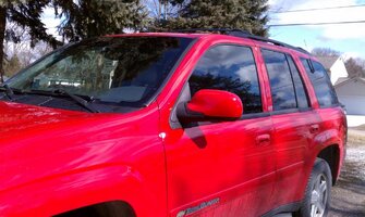

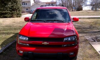

Painted the back hatch and mirrors. Also removed the black plastic pillars between the doors, it was already color matched underneath.
