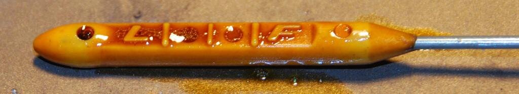

By the way, here are pictures of my dipstick while engine is running, one for each time I wiped and then dipped in... as you can see there are bubbles present or foam...
I know you can't check the level while engine runs but no two times aren't consistent.

Changing direction a little but I learned to check oil when warm but the engine not running. Usually I give it 10 minutes to drain back down to the pan. Have I been doing it wrong all these years.
Yep, that is the correct way to check. The amsoil dealer I bought my kit from told me to check the level after the engine cools overnight. :crazy:
May I ask, what kind of dipstick do you have and do you have somewhat of a hard time reading it? I think using a light source and shining it might be the trick.
:iagree: , you may be getting the bubbles just because the engine is running and no consistency because the dipstick seldom comes out the same every time.
Anyone else has bubbles when checking their dipstick while engine running? So the bubbles wouldn't necessarily mean that I'm overfilled on oil? I know there could be engine damage, overheating and/or seals go out due to over filling of oil.

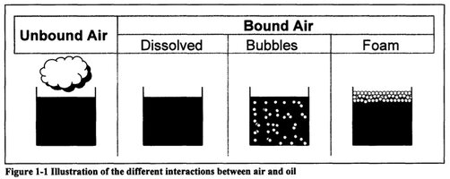

Here's a figure of different aeration:
There is a paper written about oil aeration by a MIT student. He used a Ford 3.0 L V6 duel overhead cam (DOHC) engine. His claim is that when the engine is filled with more oil, the % of aeration is decreased proportional to the RPM. I'm assuming that would not be the case with our engines. http://dspace.mit.edu/bitstream/handle/1721.1/38713/166145859.pdf
I believe if the engine is overfilled, the oil would touch the crankshaft which would cause aeration because of churning. This is what i've read somewhere...
