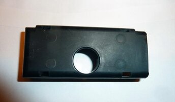

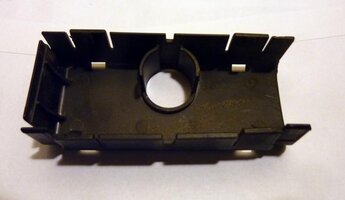

I found this laying on top of the skid plate a few weeks ago. Any idea what the heck it is?
I bought the truck a couple months ago and am still finding little surprises here and there. Don't get me wrong, I love the truck. :wootwoot:

View attachment 26268.jpg]I am guessing the pcm connector back cover. Look at the computer on the left side of the engine. if you see the wires in the back of the connector that is the cover for those wires.
mrphoenix80 said:
View attachment 12226I am guessing the pcm connector back cover. Look at the computer on the left side of the engine. if you see the wires in the back of the connector that is the cover for those wires.
Good call on this. That's exactly what it is. Wonder if its been tuned!?!
