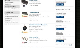

n0kfb said:
I've had my share of disapointments with GM customer service, but I don't quite understand the issue here.
I just checked Napaonline.com, and they have a motor mount for my '06 V8 Envoy for $80.
-- Dan Meyer :coffee:
You will when you sort only for the V8. I just looked and the wonderful mount proudly displays; until you click on the 5.3 and remove the I6 from the sort list. Sorry.
I replied to your post yesterday Dan, with pics from Napaonline. It's waiting for a moderator or something for approval. What you are seeing are the I6 mounts. When you filter out the six cylinder results, you'll understand the issue. However, if you see my post before this one, there are some options. They are just a little harder to find. Still overpriced for an aftermarket mount though. Unfortunately, I have not read good things about DEA mounts.
