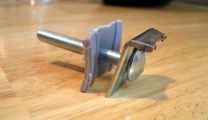

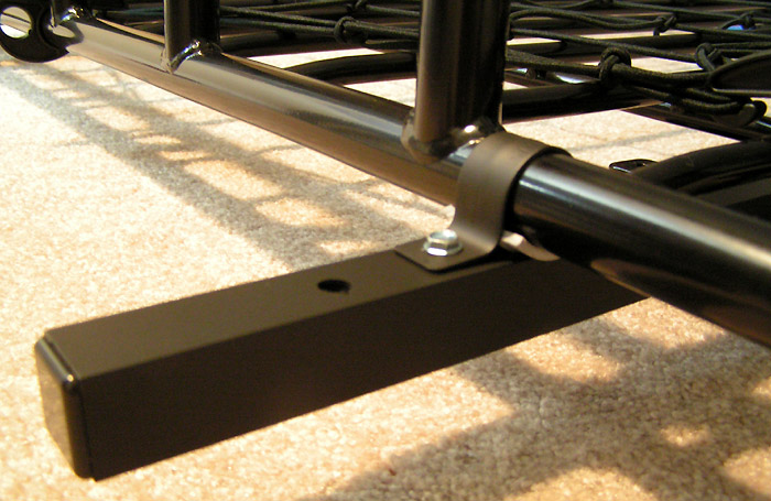

PHASE 0 - BAJA RACK & FUEL CAN HOLDER
At first price point was a big factor in considering roof rack. I was going to purchase a Surco Safari Rack, but when I started pricing out the extra pieces for mounting fuel cans and other things I realized that price point differences where coming within 50-100$ savings. I felt that for a large purchase, if I'm not saving more than $100 then I should just get the better product.
With price point out of the way, total weight, carrying capacity and strength where the main considerations for purchasing a rack.
I was very close to purchasing the Mega Mule after Jon A.'s post about his installation of that rack: offroadTB.com - View topic - Baja Rack MegaMule with Custom Brackets It looks like it would fit the trailblazer better, but I wasn't keen on how it hung over the roof rails.
Also with a sunroof and the light bar, I felt the mega mule might push too far forward. (Although now with hindsight I realize I could of mounted the lights to the MegaMule) So I went ahead and followed JamesDowning's footsteps and purchased the Baja Rack directly from BajaRack.com. I also purchased their Nato fuel can holder.
The fuel cans are 20L (5 gal) NATO issue purchased from Cheaperthandirt.com for about $44.00 a piece.
I really love these cans. They are metal, very durable and have a great seal and locking mechanism. They held up extremely well on our 5,500+ miles road trip over some pretty rough terrain.
I originally mounted the Baja rack in the same way JD outlined in his thread: offroadTB.com - View topic - MOD: Baja Rack - Roof Rack
Baja Rack makes a kit for mounting Axes and Shovels but it runs 70$. For 10$ I purchased the above seen QuikFist Clamps: Original Quick Fist® Clamp for mounting tools & equipment 1" - 2-1/4" diameter (Pack of 2) - Amazon.com
The custom installation of the Baja Rack held up pretty well over course of our trip and driving around town.

After a year of the Baja rack on the roof a few problems developed with the original mounting. It couldn't handle the weight and was beginning to tear. Originally the rack was mounted using 1"x1" aluminum extrusions and the rack is held by a 1" pipe clamp.
ORIGINAL MOUNTING:
We switched to larger 1.50 inch steel bar and used U-Bolts to mount the rack to the cross bars. Then we upgraded the bolts used to retain the bars into the roof rack by welding steel plates onto bolt heads and grinding them down.
