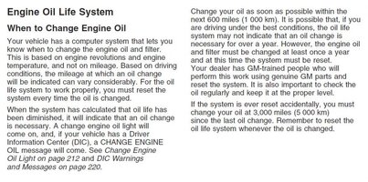

I changed the oil last night and it turns out I was down about 2 1/2 qts. everything seems to be working fine now and the warning is gone. Can anyone tell me how often to change oil in the V8. The manual says when the change oil indicator comes on. on older vehicles I followed the 3 month / 300 mile rule but newe vehicles are supposed to run longer without a change. And how much oil should I be burning normally?

3 months or 3,000 miles is simply not applicable with today's modern oils and modern engine design / build. I think you should be fine following the oil life computer.
