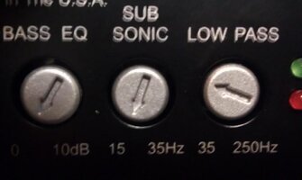

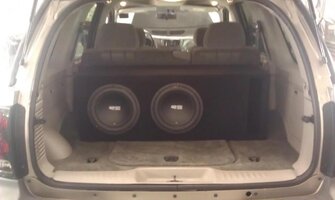

So I got the 2 RE Audio SEX 12d4's hooked up to a hifonics BRZ1200.1 and to say the least, Im not impressed. My 200 watt system was just the same. Im gonna have to look inside the box and check my wiring again, although Im 99% sure its right.
Supposedly im pushing 1200 watts at 1ohm. I have to jack the volume on my deck so high. The gain on the amp is set to about 75% and the bass knob is 50%. Sub Level on my deck is maxed out and the lpf is set to 55hz. The subs excursion is nothing like I expected it to be. I get some bass but not $600 worth lol.
Im not sure where to start exactly. The settings on the amp confuse me. HELP! :frown:

Are your subs wired to 1OHM? Your settings don't look to bad try bumping the low pass up and you shouldn't really need too much of that bass Eq but you can try to bump it up. Usually the problem your experiencing is an input level issue in my experience but that's already looking pretty good but you can bottom it out to see if you hit your gain. Those bass knobs will give weird cutoff points sometimes.
Maxxsonics isn't letting me download the manual but Im pretty sure that's a level control knob. Where it maxes out at is equal to the gain setting on the amp. So at 50%, it's only at half throttle. Try backing the gain of the amp all the way down, then turn the knob all the way up, and then adjust the gain on the amp normally.
The other settings look ok but I'd turn subsonic about 3/4 of the way up.
I think may03s advice will get you to the sound you want, Just don't wake up the neighbors while tuning.:thumbsup:

Man this amp is rude lol , my next step would be get that input level down to 0.2V then try the process from there, I had the Hifonics Zeus 5 channel and I had a similar problem on the initial tune until I bottomed that voltage.

Input Voltage- 0.2 V
Low Pass Filter- 100-120hz
Subsonic- 20-30hz
Knob- 75%-100%
Bass EQ- progressive adjustments.
Try that and see if you get your bump then re adjust your Low Pass Filter, I only say 120hz because it makes it easier for me atleast to get the level and gain I want then I cut it back to get the Hz shelf Im looking for. :twocents:

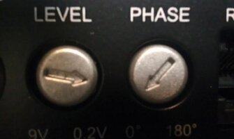

Ok let me ask this. Is it ok to be running the level turned all the way up? (aka: at 0.2v) If I turn the level on the amp all the way to 0.2v I see improvement.
And also the bass knob at 100%? I hear people say to never use the boost so ya, Im lost.
Sorry I keep posting nonstop here but im on a roll.
The manual for the amp says to match the level on the amp with the output sensitivity on the HU. The RCA's on the HU have a 2.5v output. So I assume I should set the level on the amp to 2.5v then and go from there.
The problem is people using Maxed out Gains, I have used bass knobs without disaster many times. Anyway just keep it around 3/4 for your comfort lol. The 0.2v is just boosting your RCA signal to get a good signal carry from HU to Amp. But I would keep it at 0.2v then bump you gain slightly until you hit your level, just don't max it. Blowing a RE is not an easy task, listen for clipping which is basically when your sub is going to far. Just progress your gain slightly and you should hit your mark.DON'T MAX IT! I have had 1000rms running to 600rms and 700rms subs without issue its all about tuning and not cranking a HU to the max to get bass! :thumbsup:

Ok you ready here we go lol
Tuning Simplified
Tune to match your HU
Start with your input voltage bottom it out to 0.2v then turn your head unit up if you hear clipping turn the voltage UP until your able to bump your HU at a higher volume. Make sure your Bass EQ is on 0 while doing this. So now your matched to your HU. See where your at with the bass by then.
The BASS EQ is boosting the lower HZ 40-80ish to make the bass louder, this is where people get bitter. Its not going to blow your subs if used correctly but can diminish sound quality sometimes its unnoticeable but it can give sloppy bass.
The Sub Sonic is for a ported box, If you know what HZ your box is built for if you used plans you can adjust to the frequency, If not a guestimate wot kill you here.
From my knowledge your knob works as a "remote" bass boost they do come in handy if its like 6 AM and you do not feel like trunk bumpin lol.
After you get your amp tuned then you can adjust your Low Pass to hit the level you want. I hope this clears it all up.

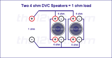

Have you confirmed with a meter that you are presenting a 1 ohm load to the amp? If they are wired any other way you would be getting a lot less than 1200 watts and there wouldn't be a whole lot of difference from the amp you had. Going to 200 watts to 400 watts for example, if changing nothing else, wouldn't be very noticeable.

So I just turned the level to .02v and subsonic at 33hz(box tuned) and the bass knob at 75% and they POUND. Cranked up the bass knob to 100% and I still see no red light on the bass knob. Hopefully thats a good thing. I wont be keeping the bass knob turned up that far anyway. Progress! In other news my back door speakers are blown to shit :undecided:

Disconnect the speaker leads from the amp. Set your DMM to ohms/continuity. Put one wire from the DMM on one speaker wire, the other DMM lead on the other speaker wire. This will tell you/us what the load is.

Will I be able to leave the level at 0.2v as long as I dont max out the bass knob safely?
I would do it the opposite, I'd max out the knob and keep the amp at 2.5v. Higher adjustments like .2v are more likely to induct noise. Remember, that knob you have isn't like a bass boost knob that you're used to. The bass knob like the one for my RF T20001bd will boost a specific frequency from 0-18db. The remote knob that you have will adjust the level output up to the the gain setting on the amp. So if the gain setting on the amp is .2v, the knob will adjust all the way up to .2v. At .2v, I'd suspect the clip light would come on 3/4 of the way up on the knob.
