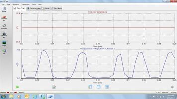

took a drive, around the neighborhood to get things up to normal operating temp
looks like 5 peaks in 15 seconds.
funny thing is, there are a couple oxygen sensor diagnostics in the emissions tests which read fine.
Guess I will order the sensor and a socket. Rock auto posted a discount someplace if I recall.

GM is recommended. The peaks @ 5 second intervals don't tell the story though. The sensor changes voltages in steps like..... .350, .570. ,980, .245, .430, .890, etc. The changes are what you are looking at, not the peaks or valleys. Still, with that mileage I would surely change it but if it's popping out values @ 2 per second then it could be good, just catch-22 at that mileage.
meerschm
Aug 26, 2012
1,079
so five cycles in 15 seconds is 3 seconds per cycle or 1.3 Hz.
thought the sign of lazy sensor is slow cycles, over 1 Hz.
I found some posts by Roadie and discussion of some scope traces, but my google foo is getting weak. (need breakfast and a walk)

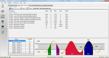

The test here looks like the critical measures are rise time and fall time.
(as well as the fact that the sensor transitions from indicating too rich to too lean)
:undecided:
Service manual does a nice job explaining the codes related to the Heated O2 Sensor (HO2S)
codes are listed for no toggle, too slow rise time, too slow fall time, stays in the middle, or if sensor heater current is out of range.
looks like the reading above is from a stored diagnostic run once per ignition cycle, after the temps come up to speed.
