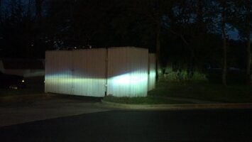

I have seen them with the HID setup and without. I ordered my HID kits from a dealer on Amazon as the price was way cheaper than the headlights+HID on ebay. The halos can be hooked up however you want them to be, you could run a switch, direct to the turn signals, DRL etc. I ran mine to the running lights so they would come on when I start the truck, they basically take the place of my DRL. They have 2 wires POS & NEG. I wired them to a relay and had the relay tied into the running lights. From time to time one of the halo's may not come on all the way like when I disarm the truck they lights flash on and off, but within the time it takes me to walk to the drivers side door they are all on. All of the lights are plug and play, the only real wiring I did was run the power to the relay.
I have no complaints about the light output, my issue is with the cutoff instead of being a straight __ __ cutoff they are more __/ __/. Which tends to throw alot of light at on coming cars. There was a guy on the OS that had modified the metal that is the cutoff inside of the projector lens itself, from what I remember he had them pretty straight using a razor blade. When I get some good free time I may pull them back off and play with this.
