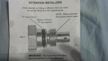

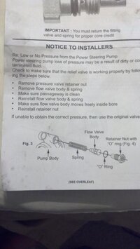

Hey. Does anyone know what this piece of paper included with the new pump is saying? I'm assuming it means to use the original nut if it takes a smaller or larger size hose connection?

When I replaced my pump not to long ago I had a simmilar paper, but it was so that I would know were the new o ring goes. Did they send you a replacement o ring too?

No I didn't replace the o-ring. I never took the valve apart on the new pump so I am assuming there was one already on it seeing how I don't have any leaks. Should i have used the old valve? It seems like the pressure is a bit low compared to my last pump which was making noise and had 120k on it.
You could try switching the valve. Not to ask a stupid question, but did you bleed the system of air after installing the new pump?

Yes. There really is no method to purging the air from these pumps they are vane pumps so air is naturally purged when its running.
I am gonna switch the valves and see what happens. I don't see what harm it could do.
I put the old nut on the new pump. Guess what? It works! :wootwoot:
Looking carefully at the nut on the old pump it has a bigger opening to allow more fluid to get pumped out. I must have a bigger steering gear or something than the swb trucks have. More fluid volume for a heavier truck or maybe tighter turning radius.
So I guess it goes to show you to never throw away those notes that are included with remanufactured parts.
Good find! I know the LWB have a smaller pulley on the pump (the reason for the shorter serpentine belt) so the pump puts out more pressure at low speed you might need in a parking lot. But I'm not sure the rack is different.
My guess - the cheap reman pump came with the wrong insert.
Yep. Had to swap inserts. It's been running good for the past few weeks towing a 5k trailer. It's even easier to steer and quieter than when I initially installed the pump. Must have needed some break-in time.

Well if memory serves the steering was worse when the valve parts werent swapped. It was harder to turn the wheel as if my front tires were flat. Its possible you got a remanned ext pump but no way to tell now unless you measure the orifice. I don't have any specs. The instructions that came with my fenco pump said to reuse the old valve/nut swap it over. Made a huge difference in feel. No difference in noise that I can remember. I still have a slight noise coming from the pump but it seems normal as it is drowned out pretty much with the other engine noise. But I no longer have the higher pitched whirring noise. And its not so much the valve that needs to be swapped over. The retaining nut is the key differentiator. The retaining nut has different sized holes that made the difference for me. The hole in the retaining nut is bigger for the ext/xl. Refer to the diagram way up ^ there.
