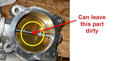

Yeah but then its not going to be all shined up and people won't feel as good I know i wouldnt :biggrin: that's an uphill battle your fighting
My guess is that when its in the center your not restricting anything when your edge is pure black your gunking the butterfly and the action is going to be altered....could be some roadie super secret reason but thats my guess.
No secret technical reason. I just like poking at the OCD population and see if they'll get over it with a little Roadie-tough-love therapy. Even if THEIRS are clean, it sometimes bothers them when they know MINE isn't. :raspberry:
