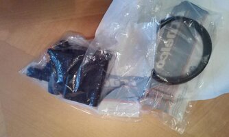

I went to the dealer today and picked up a seal and a vent valve in hopes one of them may be bad. Naturally I wont open them until I can confirm but since they are closed on Sunday I wanted to have them just in case.

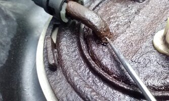

So I dropped the tank which was actually relatively easy to do, just run as much fuel out as possible. Seems to some corporate folks, VA doesn't get much road salt....:crazy:
Looks like meerschm was correct, about a week until it hits the fan. I can say for certain if you smell fuel don't wait it out, find the cause right now. I was lucky, that's a decent size hole in that elbow.

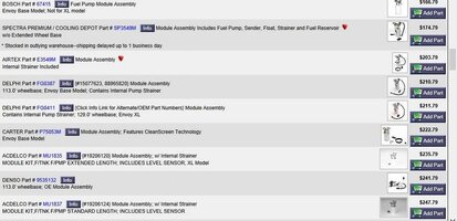

Any opinions on pumps? I want to stick with OEM but not sure if Delphi, Denso, or even the AC is OE. I assume AC is but I only want to buy this once. :smile:

Here is slightly better price on the AC Delco ACDelco MU1837 Fuel Tank and Pump Module Kit : Amazon.com : Automotive
That's the one I'm going with, thanks.

Just wanted to say thanks for the info posted in this thread. I started noticing a faint gas odor a week ago or so, at first I attributed it to the environment (gas station, fuel for lawn mower, etc) Then I checked around the engine and looked underneath and didn't see any evidence of a leak. Took my daughter back to school on Friday and over the 3 hr trip the smell got worse and stronger. Also noticed my fuel mileage was not up to normal. When I got home I did a search and found a couple threads about the fuel pump. Great knowing what to look for before I even get dirty. Pump was rusted like the pic GMCMAN posted. A long afternoon and this problem is behind me. Now just have to deal with the shift cable bushing and the liftgate module. Seems to be all falling apart at once here!!
