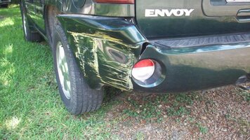

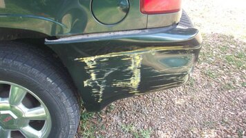

We backed into a light poll at the grocery store. The insurance company will fix it but raise the rate at $96 a month, so I'll fix it myself. It doesn't look like the rebar is hurt, just the plastic cover.
I'd like some instruction on how to remove the bumper and/or cover please.

Off the top of my head, you have the screws along the top of the bumper cover, just below the lift gate. There's a screw on either side, in the wheel well near the top of the bumper #2 in the pic, and then underneath there are 4 plastic clips that have to be popped loose, #3 in the pic.

Thanks for the info., I looked at the bumper and am going to change it myself but will have to have it painted. We have to fix some mechanical issues first and the pretty stuff in a few months.
