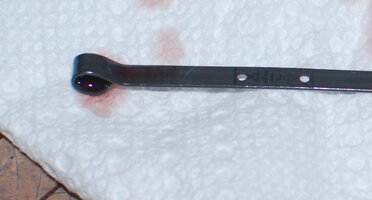

meerschm said:
I hope the pink stuff is probably fine, but is not the common spec for DEXRON VI
Funny. I'm not sure if your being sarcastic or serious.
meerschm
Aug 26, 2012
1,079
CaptainXL said:
Sure, it's red in a clear container but I was referring to pulling out the dipstick and wiping it on a white rag. Red on White...Sure looks pink to me.
Your post indicated that it was red before you had it serviced, and after the dealer flushed it, it was pink.
"...it turned to a light pink which is optimal and nominal. "
I was not being sarcastic, but did not want to be alarmist either. I have no idea what the fluid is in your trans. I hope it is fine.
my whole point is that trans fluid is supposed to be red. search for pink ATF for interesting discussion. creamy pink is a sign of water in the fluid.
CaptainXL
2,445
My point was that it was a deeper slightly burnt red in color indicating it needed to be changed.
Whats shown here is pink. This is what my dipstick looks like.
Mine was second from the right. Now its second from the left.
