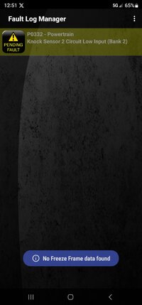

I tried to do the freeze frame of the check engine code within Torque Pro app, but it wont show any info about it. see attached screenshots...
Not sure but I don't think a "pending fault" will cause a freeze frame snap shot since the fault hasn't actually occurred as the conditions for settings the code haven't been met.... my guess / read.
Yeah, I'm not sure why the Torque Pro shows it as just a pending fault but it is causing a check engine light and on my other obd2 reader, it shows to be both a fault and a pending fault code.
