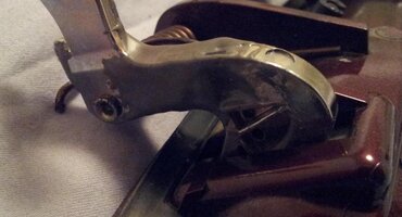

Last week, I noticed the exterior driver's door handle awkwardly stressed when pulled upward. Today, finally had a few minutes to pull the door panel off and take a closer look. The plated plastic arm (noted in the 2nd picture) was completely cracked and separated. I had some all purpose epoxy on hand to glue it back together. Will reinstall it tomorrow but now I'm wondering if it will hold up to all the years of abuse a handle takes. Anyone have a suggestion in repairing a clean crack in molded plastic parts? Super glue epoxy's always disappoint me. I'm sure I can source another one but I be even happier if I can find a < $5 fix.

I've never had good luck with ANY product that doesn't mold around the gap and add bulk strength of its own. JB Weld. Cyanoacrylates like thin gaps, but are better at flat to flat sorts of issues where you have a good number of square inches to work with. Epoxies can be good for bulk strength, but many are fast curing that sacrifice strength. If JB Weld doesn't work, nothing will. (IMHO).
Thanks Bill. I'll make a run up to Home Depot in the AM for some JB Weld to apply as bulk over (and around) the arm. Just curious, have you seen the handles of our vehicles fail with normal usage? I was a bit shocked when I discovered the break in an obvious stress zone.
It also helps if you can embed some metal in the epoxy to strengthen it.

No. A piece of SS wire or maybe something like a paneling nail and mold the epoxy over it.
That'll keep it from pulling open and cracking the epoxy.
Also, I agree with Roadie. JB Weld is the best option.
Think of it as a splint. Sometimes I try to drill holes in both halves of broken things and use a rod or pin internally, when I've got an irreplaceable or expensive item to mend and I'm being frugal.
My outside driver door handle busted on my voy a while ago. I tried "gluing" the handle with gorilla brand glue. Thought it might hold but 1st time trying to open door it failed. So hope jb weld wrks out for ya.
Try drilling a small hole on each side of the break and the feed a wire around the 2 holes. After you JB it in the crack tighten the wire with pliers, then JB in bulk around the wire and crack. Should work.

Thanks for the input. I didn't have much clearance for lassoing the break together. I applied the quick setting epoxy last night to secure the two pieces. This morning, the bond was solid. So, I purchased JB Weld and molded the entire arm, filling in all the gaps and crevices of the formed plastic. It's been about 4 hours now and the goop will need to cure at least till tomorrow morning before I can test tensile strength.

WHen I was in Home Depot this morning, I noticed the QuikSteel. You're absolutely right about the gooey liquid application style of the JB Weld epoxy. It's initial bonding time is 6 hours. Then a full 24 hours to dry completely. Not the most user friendly goop. :no:
I like JB Weld for some projects, especially filling cavities and/or voids blindly. But in some instances the clay like properties of QuikSteel are indispensable.

My JB Weld patch work this morning with 24 hours of set time:

Me too. I hate "epoxy'ing" when more goop finds your fingers than the actually plastic surface. The cold weld is rock hard now....so tomorrow is d-day.
I'd not bother repairing a broken handle. It won't be as strong as the original and will soon break.

1 day of general use and the handle is holding up well. The combination of a superglue epoxy for the adhesion and JB Weld as the structural cast seems to be the ticket. Crossing all my fingers.... :biggrin:

@triplebuick, I had a very similar split on that handle arm. I attempted the JB Weld fix. Worked for about 3 weeks. Then failure on a cold morning. I bit the bullet on a new handle assembly from the dealer. I swapped out just the new chrome handle by removing its loaded spring. Replaced it on my original trim assembly so I didnt have to spend the money and have it painted. The $120 hurt though for a molded piece of plastic! :hissyfit: Of coarse, Roadie's initial perspective was spot on.

It's been a while since I made the repair but IIRC, I was able to manipulate the flared end of the pin with pliers in order to separate the trim piece from the handle. I took me a good few minutes to convince it to move through. Maybe you'll have better luck with your JB repair and you won't have to disassemble your door panel again.
JB plastic weld held, but the plastic broke just a little further up from the repair. I purchased an aftermarket handle for $25. They are available on ebay and amazon. I then disassembled the new and old handle and swapped the new top handle onto the old bottom handle. Why would I do that?
Because the original bottom handle is painted the same color as my Rainier and has the lock cylinder in it. I didn't want to repaint the bottom half of the new handle. The bottom half has no moving parts and should not increase the failure rate. It is fairly easy to take the handle apart. The new one was press fitted, just used a hammer to knock the shaft out. The old one has a punched out end on the shaft. I used a drill to eliminate the enlarged end.
