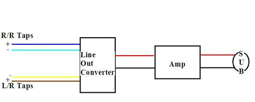

Here is a diagram of my set up
I am truly stumped.
