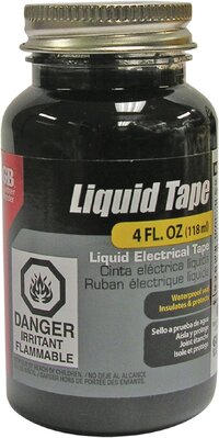

(6) Do a REALLY GOOD SOLDER AND INSULATION REPAIR on ANY Sketchy Wiring using TESA Tape to Bind Things Up.
(7) Be Suspicious and Don't Overlook the OBVIOUS... (Wrecked & Repaired Cars -R- TROUBLE!)
Liquid Tape:
TESA Tape:
