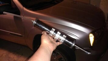

This is a pump that pumps oil into the lower end of an outboard engine. They cost about 10.00 bucks and they will screw into the Auto Trac II bottles and then you can just pump. The hose is a little longer than the suction pump and you don't have to pour any back into the bottle, just stop pumping when the overflow begins. These should be available at Walmart and Harbour Freight. If not try a marine store they will have one for sure. :thumbsup:

Also, +1 for the pump that screws into the bottle. I got one for $5 at Napa.

After reading through pages of threads here on the forums, out of general curiosity, I noticed the repeated warning of transfer case neglect. I poked my head under the driver's side to locate the TC and my stomach dropped. Oil was dripping down all around the TC. The pessimist I am, I thought for sure a seal was shot, so I lifted up the truck and climbed under. As soon as get a good look at fill plug, it is clear that is where the leak is. The plug was loose enough to unscrew by hand. I used the generic red hand pump from harbor freight to fill the transfer case fluid and it worked ok, should have tried autozone for that oil gun posted above and in may03lt's videos.
