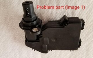

I bought a brand new disconnect on Amazon from GWA. The first time I tried driving in 4 HI it worked as it should.
When I placed it back in 2HI is when the plunger stayed in the extended position.
This is the pic I sent them. Plunger is extended when it should be more recessed.
I wonder if that cheap-o I got from Amazon is part of the problem? When I go to put the OEM in, I'll check the position and plunger. I hope it not broke inside the TC. Thanx again!
