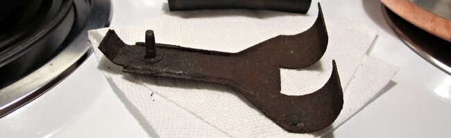

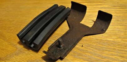

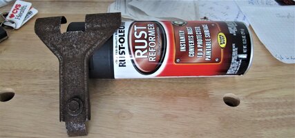

Here's the large clamp bracket and rubber grommet. Still a little rusty but will hit the steel with a needle scaler in just a few.
Lot's of people on YT bending this bracket over in order to remove the lines. I don't think they know about the bolt.
