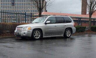

Nicely done, that looks good

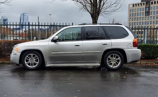

Switching from air ride to springs is quite simple. Just take out the bags themselves. When removed what's left is the same as spring cars, as in the mounts are for normal springs. Then remove the air lines and the activation switches that are connected to, if I remember right the upper suspension links.

I left the air pump in place. In the Denali there is a valve you can mount an hose to and still use the compressor for things like air mattress etc when camping and airing up your tires.
