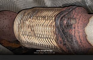

I'd use extreme caution lowering that rear portion of the exhaust. Your expansion joint is in real poor shape and is likely going to crack if it isn't already leaking. Overall....your rear exhaust system is on it's last legs. Time to consider a new rear system and fix that shield while your in there.
