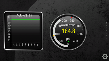

Suspecting low refrigerant levels I connected up the old ELM327 and fired up Torque Pro, graphing AC Relay Status (0x221100, bit 2) and AC Hi Side Pressure (0x221144). Sure enough, Hi side pressure was dropping below the cutoff threshold and so the AC Relay was cycling on & off. Running the rear system in addition to the front increased the heat transfer load and increased the pressure just enough to keep the AC relay On.

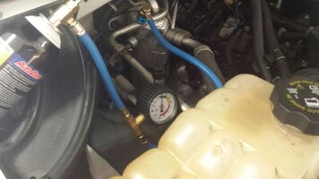

I removed the cap on the low-side/charging port, gave it a blast of air to remove any particles, and added refrigerant, keeping track of low- & hi-side and pressures. The system stabilized and all appeared to be in order.

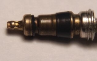

Here is a closeup of the bottom tip of the Schrader valve stem (note: tip width at the end of the valve is 1.5mm). Notice the deformation of the lower seal.
It is always the little things that nail you. In retrospect, it should not be surprising given that this part was likely original to the vehicle.
