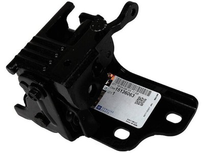

I'm sorry...I just saw this now. Was not getting notifications for anything for a while. It's probably too late now but the pictures are of the upper left latch part number 15778433. The lower Left is almost identical, but a different part number, and i don't have an actual picture of the upper right one, but it looks different cause the latch for that is on top of the mechanism to release when laying the gate down and otherwise it acts as a hinge when the door is just swung open

I am also searching for the upper left LATCH for an 04 XUV. Does anyone have one for sale?

I have an extra upper left hinge/latch, but it needs to be rebuilt as well. And I really dont want to part ways with it until I sell my XUV, which likely isnt happening.
Even if you find brand new ones, like I managed to do, they have been sitting on the shelf so long, that they have the same issue the ones being replaced have, as mine did.
The only real option, as @mrrsm alluded to with his video post above, is to soft rebuild them as WatchJRGo did in his XUV build on YouTube did.
I have not done the soft rebuild on mine, although it needs to be done.

I'm looking for the upper left tailgate latch. I took it apart, cleaned it, and tested it electrically and verified one of the microswitches is bad.
The microswitch can't easily be replaced. I had thoughts of manually rigging a switch to manually put 12V to the latch motor but it would be very complicated because the motor operates in two directions and is controlled by the module. It's really over-complicated.

Only thing I can suggest is to keep on eye on the local salvage yards, and hope you can find one to rebuild. They just arent available anywhere that I can find.
