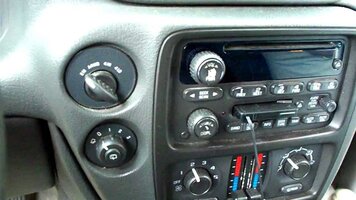

Seems like they did make a cd/cassette unit combination. I found a few online.
