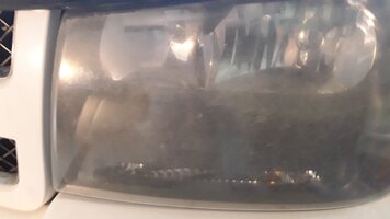

I knew headlight clearing products are all the rage these days, but do they actually work?
One of my headlights is as crisp and clear as the day it was made. The other is awful dark yellow and looks like garbage. But when I touch the lens, it feels pretty smooth, it feels like the yellowing is on the inside not the outside.
Is this normal for yellowed lenses, is a clearing product still likely to work? Or do I have some weird form of yellowing where I'm basically screwed?
