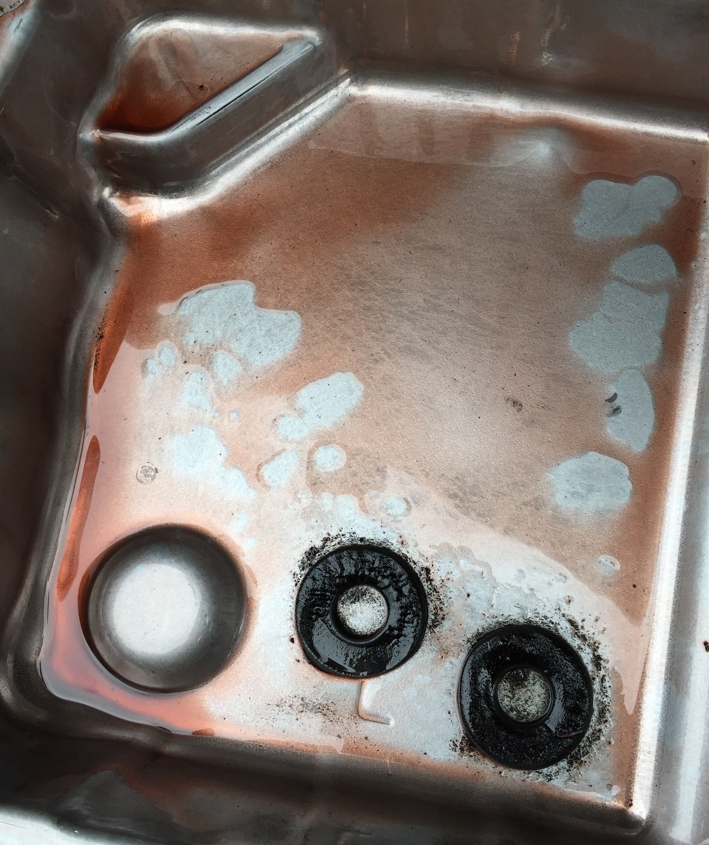

Did the pan drop today. I think the world has seen worse ATFs...
Does this look like 90k miles? The gasket looked like paper (do any aftermarket gaskets come in this form?) and the bolts were surprisingly lightly torqued.
Mounce
Mar 29, 2014
13,667
Tuscaloosa, AL
The fluid looks about on par with well treated (easy driven) 90k fluid, off-red / light brown. But that's not to say that it wasn't black and the people before you changed it but didn't get all of the old fluid out thus contaminating the fresh fluid with old.

HARDTRAILZ
49,665
Does not look too shabby. Cant remember what material my gasket was offhand though.
