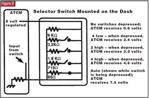

You are correct that the TCCM doesn't use 3-Volt. I knew they were different voltage, but mistook the volts. According to someone who has done the swap, the Trailblazer selector switch uses 5-Volt signal as opposed to the 246's 8-Volt signal.
Now with that said, re-reading through the thread, the OP ran a shop and could be misleading people wanting to do the swap themselves.
nrrsm posted earlier in this thread with a diagram showing an 8-Volt reference for the 246, and according to the shop manual diagram, it shows a 5-Volt reference for the selector switch on the Trailblazer.
Not sure what would be easier, using the Trailblazer switch to control the 246's TCCM or using the Trailblazer's TCCM to control the 246.
FWIW, I have run across a few instances where the wiring diagrams have incorrectly shown an 8 volt reference where in fact it was a 5 volt reference. It is my belief they are both 5 volt references in reality. My 2005 Yukon is most assuredly a 5 volt reference at the TCCM/Shift motor.
