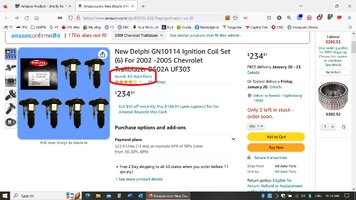

For anyone buying these that after receiving that you verify that they are TRUE Delphi units. The originals had Delphi embossed on the top and these show they're laser etched on the interior metal along with the part number. That could have been a change by Delphi but maybe not. Delphi has changed hands since so it's possible.
And the listing says "Brand: AD Auto Parts". Looking at their other listings, they seem to specialize in ignition parts for multiple car makers.
There were a couple of negative reviews, including one that said they failed within a year. Sounds like the Chinese clones.
Caveat emptor.
