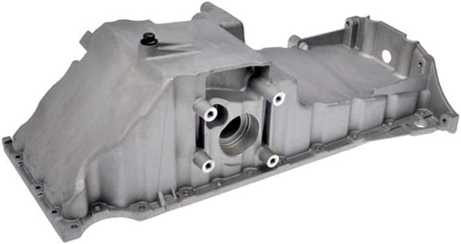

So it turns out I was naive and stupid.
Went to change the transfer case and front differential oil last week. Couldn't find it, what am I missing?? Turns out the guy who sold it to me told me it was AWD and I believed him. Nope, it's just rear drive, those were CV joints in the front. My fault for not knowing what to look for. Bummer.
Regardless, we had a successful drive to and from snow country. Had to put chains on the back tires at the summit, was very glad there's lots of clearance around the tires so it was "easy" to do.
I'm disappointed in the lack of 4wd/Awd, but this is my reality so I will take it with stride. I have my health and the truck now has a higher towing capacity and one less thing to fail! :smile:
Umm... unpossible? Unless someone removed it all. Why would you have CV joints in the front for a RWD vehicle? Yes, there are CV axles in the front. To remove the xfer case, you would need a longer driveshaft. Again, doable, but not many folks do that - most just pull the front drive shaft and CV axles and drive on.
Is that what you mean? The AWD has been neutered?
Look for videos of xfer case fluid change, front disconnect removal, and front diff fluid change and see if you have those components.

The bottom of the engine has little metal indentations where I assume the drive shafts would go. I think the guy who sold it to me either was not truthful or just didn't know it was RWD only. This car was babied and never modified from what it seems.

Do you have a large nut in the middle of the front hubs? You can see it at the beginning of that video. And on the driver side, you can see the front diff. If you have the axles, they have to terminate to the diff. A 2WD would have an empty hole in the oil pan going completely across it. They used the same pan for 2WD and 4x4 minus the hardware for it. This is the passenger side where the disconnect bolts in.
It would be weird that a Rainier came without AWD from the factory but I guess anything is possible. If it was disconnected because of something defective, like the diff, the most likely scenario is the transfer case was left there but the axles and front driveshaft were removed. The front diff is usually just left there because it's a PITA to remove. Even if the diff is removed, removing the transfer case is an even bigger PITA because they would also have to replace the transmission and driveshaft. Easier to just leave those there. There would also be some evidence of the previously existing system with connectors left dangling for the transfer case and the TCCM would also likely still be there.

Nope my front brakes don't have that spline drive "hole" in them. And the place the axle would pass through the bottom of the engine is just a metal bump. It's just a rear drive truck. Another reason to do more thorough research when buying a vehicle, especially when you are rushing and without sleep! Without there being a Hi/Lo gear selector in the Buicks it was something I took for granted given I couldn't test engagement on paved roads.
To clarify, there is no transfer case. Thus, no drain holes to find :wink:
