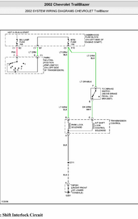

Looking at the picture, the uppermost left corner somewhat shows one of four locking tabs. If you are a carefull sort and can manipulate multiple lock tabs simultaneously it's fairly easy to disassemble and reassemble. Additionally all the other components are removable for inspection or whatever. I had a quick look just now in some of the wiring schematics (thanks to Moosemans service manuals) but thus far have found just 2 of the 3 contact sets of the brake switch. Have not located any brake switch/park lock wiring diagram yet.

Looking at the schematic, you might consider verifying good fuses etc before going after the brake switch (because it's a pain to remove)

The circuit which controls the Shift Interlock has normally closed contacts. It is the set of contact closest to the circular hole in the switch body, bottom of photo in post #2. Terminal designations are E and F, the green/white and green/black wires seen in the photo in post #5.
