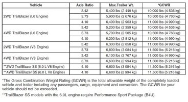

speaking of pulling things...can anyone tell me what the Envoy's tow/weight rating is? I have a 2004 Envoy XL with the V6..and never could figure out how much I can pull with it.
Owner's Manual and lots of sites have the specs posted. I don't think we have a chart here because it's easy to find elsewhere. It depends on your gear ratio, which is a code on the RPO sticker in your glove box.
I bet you'll find somebody replaced it while you weren't looking with an I6. Go look. :wink:
Owner's Manual and lots of sites have the specs posted. I don't think we have a chart here because it's easy to find elsewhere. It depends on your gear ratio, which is a code on the RPO sticker in your glove box. I bet you'll find somebody replaced it while you weren't looking with an I6. Go look. :wink:
LOL...OK, OK....I meant I6!!! :biggrin:
