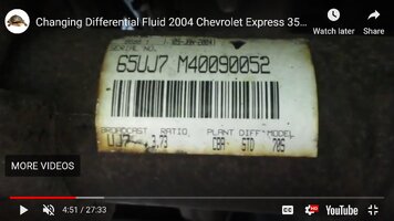

I’m a bit confussed on this rear end it has 12 bolts. I think it’s a dana super70. here’s the model #s lable.
Here’s a painted diff. cover from y tube has same van w/ same model# lable as mine.
When I look at rock auto https://www.rockauto.com/en/catalog...01,drivetrain,differential+cover+gasket,13411
I get more confussed bc I see 10 bolts an 14 bolts.
this is why I'm leaning toward making a gasket. thanks
